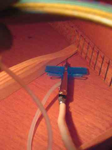

The first problem is that outside portions of the back braces on the lower
bout have come loose and buzz. Since the braces are tucked into the
linings, they can't be removed and re-glued, so is the best way to use a
syringe to glue them back down, or maybe wick in some CA? Those were
the two options I have considered so far. In any event this is the least of
this guitar's problems.

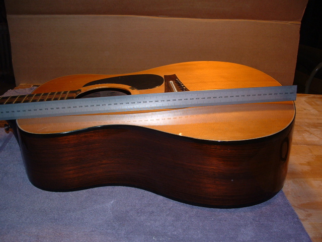

The most obvious problem is the neck. I hear Gibsons from this era were
notorious for warped necks. Well, this one has a doozie:
Jeff Elliott has told me used to do a lot of repairs on warped Gibson necks
and he would pull the frets, plane the fretboard back to where it needed
to be and re-fret. I think this one is too far gone for that.

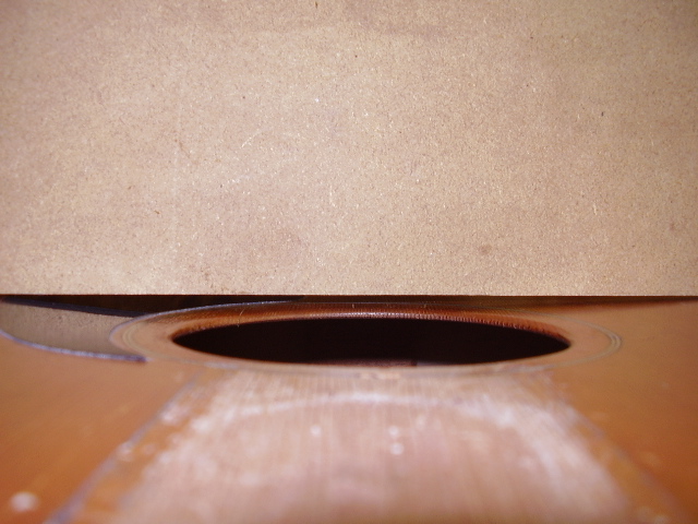

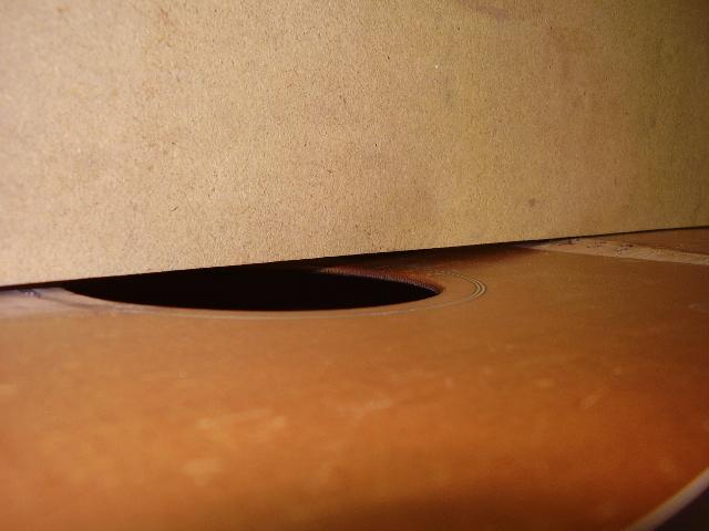

The other big problem is the top has deformed pretty dramatically. There
is a good belly below bridge and the top has sunken above:
The result is that the action is pretty high of course and the break angle
at the saddle is very shallow.

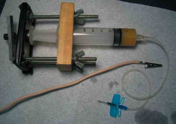

As to the back braces, butterfly needles are a wonderful thing. They can
be hard to find, but sometimes your local hospital may sell them to you. I
spent about 10 minutes making a plunger for the syringe (the needles are
only available in a very fine gauge and can be hard to force glue through),
and keep it in a glass of water when not using it. Then I soldered an
alligator clip to a chunk of solid 10awg electrical wire, and use this tool
all the time. If you don't want to go through all this trouble just work glue
in with your finger and a feeler gauge and clean it up when you're done.

I love that glue jig...neat!

David, I love the butterfly needle setup! I'll have to get something like that
set up whether I use it on this guitar or not.

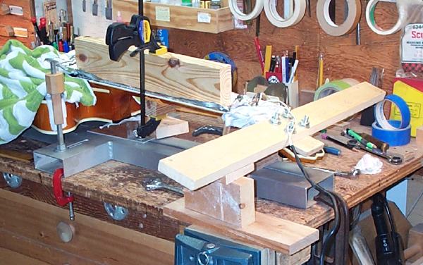

I wouldn't remove the neck unless it is in need of a neck set to fix a
high action.
Removing the twist is actually easier with the neck attached to the
body, assuming your doing a heatset. The reason for this is that the
body gives you a way to control the neck when trying to untwist it.
My setup for the heatset can be seen in the photo. I had the guitar
clamped in my string compensation jig which was basically used to
hold the body firm. You could probably rig up a way to clamp your
guitar to your workbench. I bolted a 1x4 to the peghead to give me
a "handle" for untwisting the neck. I used a 2"x18" heating blanket
on top the fretboard which was held down with a 2x4 and the clamp.
I heated the neck up until I felt warmth on the back of the neck.
Then I propped a board under one end of the 1x4 to twist the neck
back a little further than straigth. I turned the heating blanket off
and let her cool for 24 hours. When I took the setup apart, I was
pleased to see the neck came out perfect. I kind of got lucky on this
one.

I might give that a shot. Depending on how the top comes out the neck may
have to be reset anyway, so I was thinking of just replacing it. Since this is a
learning experience, I might go for the de-twist then re-evaluate.
